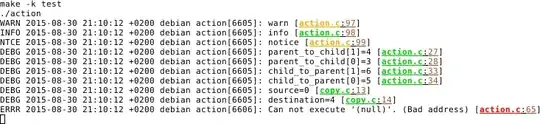

I try to define a custom coloring of the compilation buffer, but I can not get the highlight correctly.
(add-to-list 'compilation-error-regexp-alist 'my-message)
(add-to-list 'compilation-error-regexp-alist-alist
  '(my-message
    "^\\(\\(ERRR\\|CRIT\\|ALRT\\|EMRG\\)\\|\\(WARN\\|NTCE\\)\\|\\(INFO\\|DEBG\\)\\) .*\\[\\(\\([^ \n]+\\):\\([0-9]+\\)\\)\\]$"
    6 7 nil (3 . 4) 5))
This correctly colors the hyperlink:
But I can not get the beginning of the line right. I would like the tags WARN, INFO, NTCE, DEBG and ERRR to have the same color as the hyperlink. But everything I tried did not work. I get either the error, that the match does not exists of the color for all lines is fixed.
How to color the beginning of the line in the same color like the hyperlink?

Adding some additional HIGHLIGHT parameters to your list should do it. As stated in Emacs' documentation for the variable compilation-error-regexp-alist:
Additional HIGHLIGHTs take the shape (SUBMATCH FACE), where SUBMATCH is the number of a submatch and FACE is an expression which evaluates to a face name (a symbol or string).
In your case, it should reduce to something like the following:
             '(my-message
               6 7 nil (3 . 4) 5
               (2 compilation-error-face)
               (3 compilation-warning-face)
               (4 compilation-info-face)))
Another, more verbose solution might be to define multiple regular expressions for your different levels, so that all groups always match.
