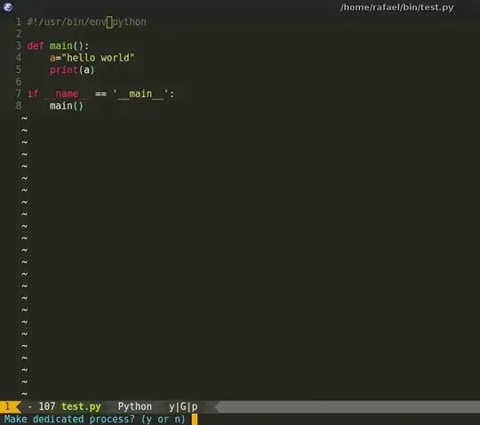

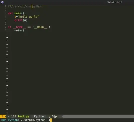

Here are my steps:
1- Switch to Shell C-c C-z
2- Click enter to accept
3- Eval-Buffer C-c C-c to run the script
I just got the following message:
sent: #!/usr/bin/env python...
Running Eval-File works fine. It's just Eval-Buffer what doesn't work.
Have I miss anything?
UPDATE:
I've just noticed that before running the script I get the following line printed in my messages buffer:
Can't guess python-indent-offset, using defaults: 4
Which is very strange because C-h-v python-indent-offset shows me that it's already set to 4 spaces...
