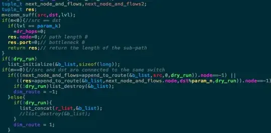

color-identifiers-mode does this for variables, if I understand your question correctly. rainbo-identifiers-mode too, I think. Screenshot is from the former one.
    Note: at least for my fonts I can barely differ the colors. The solution is to add :weight ,'bold inside the color-identifiers:colorize function. – Hi-Angel Aug 14 '17 at 21:12

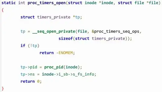

zjl-hl.el on https://www.emacswiki.org/emacs/JianliZhao exactly matches your need.
The current default color theme is designed to be used with a white background.
zjl-hl screenshot

  • A precise link and a description of exactly what this claims to do would more helpful. Supplementing with a screenshot of this in action would also improve the answer. – Andrew Swann Jun 02 '16 at 16:20
