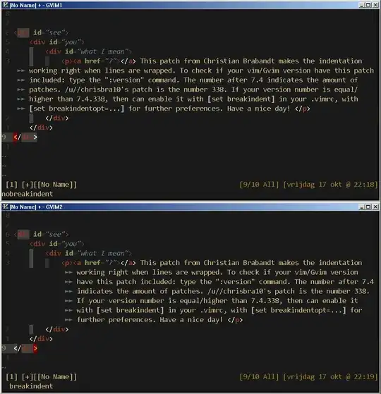

I have the following wrapped text, especially when you use a lot of windows:
Wrapped lines in Emacs
I'm wondering if the indentation of wrapped text could be changed like in Vim:
Indentation of wrapped lines in Vim
When figuring out, it seems the AutoFillMode is responsible for this. I was hoping this might be improved in Emacs 25. After upgraded to a compiled binary of Emacs 25, I see the same behaviour.
So I'm wondering if I could solve this in an another way?
