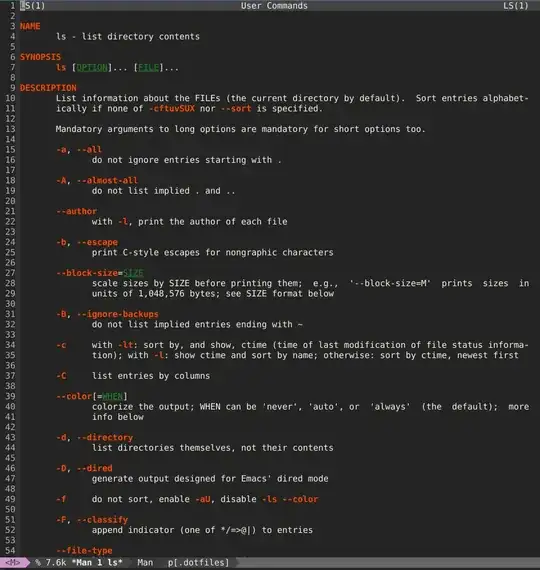

Add the follows to your init file and use M-x man or the man command in eshell to view man pages: (the colors fits the wombat theme; you can change them for yourself)
(require 'man)
(set-face-attribute 'Man-overstrike nil :inherit 'bold :foreground "orange red")
(set-face-attribute 'Man-underline nil :inherit 'underline :foreground "forest green")
Or to be theme agnostic:
(require 'man)
(set-face-attribute 'Man-overstrike nil :inherit font-lock-type-face :bold t)
(set-face-attribute 'Man-underline nil :inherit font-lock-keyword-face :underline t)
screenshot
