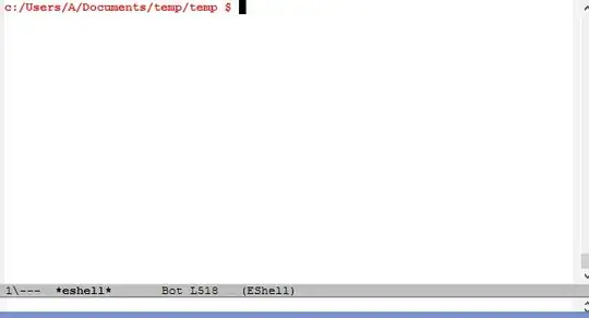

Sometimes, when I scroll up in eshell, point leaves the command prompt line to stay in the visible area. When I then enter a command, I don't enter the command at the prompt, but rater insert the text somewhere into the output of previously called commands. This is pretty annoying.
How can I make sure that eshell returns point to the command prompt when I enter a char, just like in other shells?
/edit: Here is a screencast of the situation. I type ls, then I scroll up to review the output, then decide that I want to do a cd .., but because it just inserts the command at point, it turns out to be garbage.

  • Is there the possibility to provide a screenshot of a case where the point leaves the command line and you would like to return the point to the command prompt by inserting an arbitrary character? Is the left point in the same line that the last prompt? Do you like to return to the last prompt? What if there is some incompleted text at the last prompt? – Name Jul 25 '15 at 05:36
  • @xuchunyang: The problem is really that the point moves away from the prompt when I don't want it to (i.e., when I scroll up, see the screencast). So having the point stay at the prompt unless I move it somewhere by myself would be the 'real' solution. Seems like the point must always be in the visible area in emacs though. – Geier Jul 26 '15 at 20:18
(setq eshell-scroll-to-bottom-on-input t)
should do what you want.
