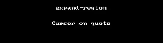

If point is next to a single quote
The black vertical rectangles below indicate how the cursor will look.
# point on left of left quote, the cursor is hiding the quote under it
ref = open(▮specific-file-name')
point on left of right parenthesis, the cursor is hiding the parenthesis under it
ref = open('specific-file-name'▮
In either case, when you do M-x er/expand-region, 'specific-file-name' will get selected and you can then hit DEL (or backspace) to delete the selection.
If you have delete-selection-mode enabled (I like to have that enabled personally), you can start typing away after doing the selection and that will overwrite the selection.
Of course, if you use er/expand-region a lot, you would bind it to a short key binding. I like to bind it to C-\. So with point next to a single quote: C-\fname will give me ref = open(fname);

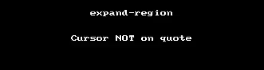

If point is somewhere inside the quotes
Using expand-region, the point does not need to be near the quotes. But in this case, you will need just few more (usually one or two more) key strokes.
Let's say the cursor position is as below now:
# cursor shown below is hiding the i character under it
ref = open('specif▮c-file-name')
Using the same binding as I used above:
  • First time I hit C-\ will select specific.
  • Now I just need to hit \ to expand the selection (expand-region feature). That will select specific-file-name.
    If you had bound er/expand-region to C-=, hitting = again will do the incremental expansion. Read its documentation on how to binding keys for incremental expansion/contraction of selection.
  • Hitting \ once more will select 'specific-file-name'.
  • Now you proceed with hitting DEL to delete the selection and then type fname. If delete-selection-mode is enabled, you can skip the DEL stroke.
In summary, with delete-selection-mode enabled, the key strokes look like: C-\\\fname.
