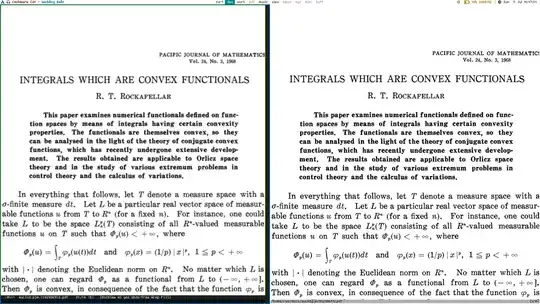

However, the following screenshot says otherwise:
emacs doc-view vs zathura with mupdf
Emacs using doc-view on the left, zathura with mupdf backend on the right. Same pdf file, zoomed by hand to approximately the same level. The pdf is here.
As you can see, in the sentence starting with "For instance" for example, the superscript p, and the subscript n are much clearer in zathura. In doc-view, the n in particular is barely readable, if at all, even at this level of zoom.

    Try to run mudraw with the same arguments as docview does, and compare the quality of the resulting image. –  Jul 05 '15 at 12:31
  • How do I use mudraw? For example I used mudraw -o euclid.png euclid.pjm.1102986512.pdf but the euclid.png file is just a blank (white) page. – vyp Jul 05 '15 at 12:34
  • Nevermind, I did it by specifying the page number 1 at the end of that command. However, the image quality is worse than even the doc-view one. – vyp Jul 05 '15 at 12:38
    Okay I set the resolution better, to 300 using the -r option. http://i.imgur.com/P9kK9Sj.png. So (setq doc-view-resolution 300) is the solution. (After (doc-view-clear-cache).) – vyp Jul 05 '15 at 12:46
    Please turn your last comment into an answer and accept it, to help other users which have the same problem. –  Jul 05 '15 at 12:47
    For the record I've settled on a dpi of 144 because it seems to be a tradeoff between speed and quality. – vyp Jul 05 '15 at 12:56
  • To be fair, I would have never have figured out it was just the resolution setting if you hadn't suggested using mudraw directly to test. I was looking for solutions for some time before asking here. -_- – vyp Jul 05 '15 at 13:09
The default resolution is probably around 90 dpi.
