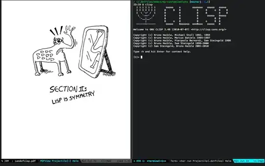

  • I started/re-started my emacs --daemon server (ie turned on/off my computer)
  • re-installed the pdf-tools package again (I had tried this, yes)
  • Installed CLISP via homebrew (I have a suspicion this may have helped the script find the right directories because when I was running it via pdf-tools-install it was asking for a directory where autogen.sh was and I was pointing it to the elpa/pdf-tools directory and had tried /usr/local/Cask/... directories where homebrew installed Emacs. Maybe this helped it find the right ones?
Anyways, super happy now as can have my PDF's inside Emacs and as an extra bonus it seems to render eww buffers much better too.
Best of luck to other OSX users getting it up and working. Please post if you pinpoint what helped you get it set up.
