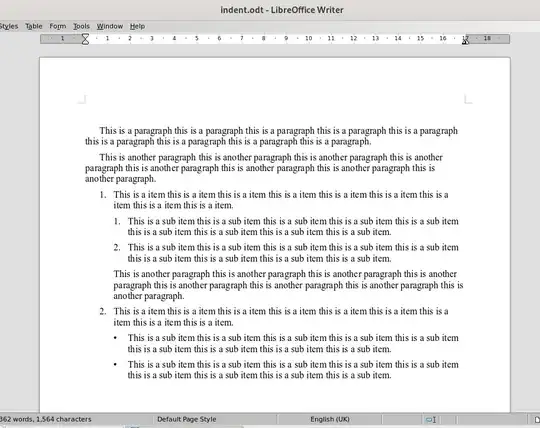

Does the image below capture what you have in mind?
Paragraph with First Line Indent
If yes, try the snippet below. For the snippet to work, you need to install the The enhanced ODT exporter with M-x package-install.

The style configuration will look a bit overwhelming, at first. You can learn about it in
  1. Create a stylesheet for your OpenDocument files, and inline the XML definitions right in your Org file–Think HTML_HEAD, or HTML_HEAD_EXTRA but for ODT / DOCX files
  2. Applying custom styles through keywords .
http://orgmode.org/manual/Applying-custom-styles.html#Applying-custom-styles
^^ This is what I did. The page has instructions to generate an empty ODT template. Then you can go into LibreOffice, edit the Text Body paragraph style to set the first-line indent, and save the template.
Then add #+ODT_STYLES_FILE: "/path/to/my-stylesheet.odt" (or ott, depending how you saved it) into your org document. The exported ODT file will use the style definitions from your template, instead of the defaults.
Worked for me.
