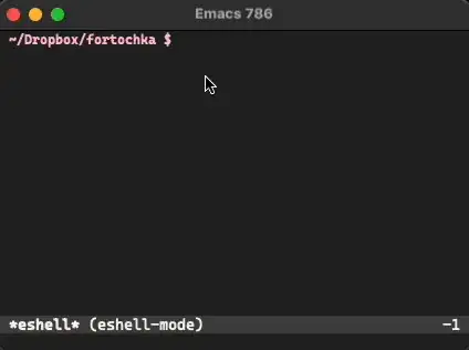

After looking at this answer I find it hard to believe there is no way to clear the eShell.
Does anybody know of a short function or method to delete the entire buffer. Pressing C-l just scrolls the text, as soon as enter is pressed all of that text comes back.
Thanks
Startec
  • 1,344
7 Answers7
20
Running clear with 1, as in clear 1 works.
How could you have found this out? We know we want to look for a function about eshell and it has to do with clear. So, why not do C-h f and type eshell clear. This produces two functions:
  1. eshell/clear-scrollback
  2. eshell/clear
If we select eshell-scrollback, Emacs shows us usage:
eshell/clear-scrollback is a compiled Lisp function in ‘esh-mode.el’.
(eshell/clear-scrollback)
Clear the scrollback content of the eshell window.
We try running eshell/clear-scrollback and it clears the screen. Ok, we can look at it's implementation but before that let's look at the other function eshell/clear. When we select that after C-h f and eshell clear, we get:
eshell/clear is an interactive compiled Lisp function in
‘esh-mode.el’.
(eshell/clear &optional SCROLLBACK)
Scroll contents of eshell window out of sight, leaving a blank window. If SCROLLBACK is non-nil, clear the scrollback contents.
This tells us that we could run clear 1 to clear the screen. But, why are there two functions? If we look at the implementation of eshell/clear, we can see that the other function is actually used in it. To find the implementation simply click on the esh-mode.el in the usage buffer of eshell/clear.
(defun eshell/clear (&optional scrollback)
  "Scroll contents of eshell window out of sight, leaving a blank window.
If SCROLLBACK is non-nil, clear the scrollback contents."
  (interactive)
  (if scrollback
    (insert (make-string (window-size) ?\n))
    (eshell-send-input)))
