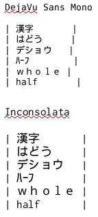

I've had this right at one point in the past on one machine with a certain font type at a particular font size, but I can't seem to get it right again.
Look e.g. at how my org mode tables look once I add Japanese characters. Here are two examples using fonts that were supposed to align properly (I read somewhere).
DejaVu Sans Mono Book 10
Insolata Medium 10

Edit A copy-and-pasteable version of a bunch of alignment problems for anyone who wants to try themselves:
| a 漢字       |   |
| b はどう     |   |
| f デショウ a |   |
| ハーフ          |   |
| whole   |   |
| half         |   |

The solution turned out to be surprisingly easy. After adding
(set-default-font "Inconsolata-12")
to the end of my ~/.emacs, it kind of (see below for details) worked.
Emacs Inconsolata 12

After copy-and-pasting the table into LibreOffice I noticed that Inconsolata worked, whereas DejaVu Sans Mono does not - which depends, I suppose, on my xorg font substitution settings. (My LibreOffice font substitution settings are empty.) To wit:
LibreOffice rendering of org-table format
That lead me to just play around with Inconsolata in emacs a little more, and to the set-default-font solution mentioned above.
Not all font sizes work however, and if I increase/decrease the font size, the alignment gets messed up again. Here are the results for the sizes I tried:
