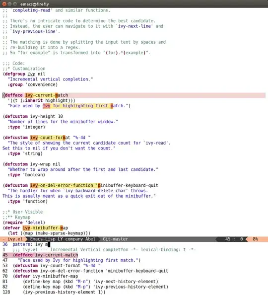

If you use swiper and search for snake case, it will match both snake_case and snake-case.
swiper is a new isearch alternative that gives you an overview in the minibuffer as you search.
In the image above, the input is ivy m that translates to the regex ivy.*m. There are 36 matches for this regex. You can navigate between them with C-s/C-r or C-n/ C-p.
You can install swiper with M-x package-install. It's available in both MELPA and GNU ELPA.

  • swiper (and swiper-helm) are neat. I've added them to my setup and am trying them out for a few days. Not quite what I was after though as I'll have to type something different than what I'm searching for, will see if I get used to that. Also, any idea how to get C-w and M-e work while in swiper mode? – Tom Apr 14 '15 at 05:40
  • What are C-w and M-e supposed to do? You can post at https://github.com/abo-abo/swiper/issues if you want me to add something. – abo-abo Apr 14 '15 at 08:47
  • M-e is described in the comments and other answer - it edits the search in the minibuffer. C-w expands the search term with the symbol under the cursor. – Tom Apr 14 '15 at 23:28
  • OK, you don't need M-e for swiper, it's already in M-e. And to get the thing at point, press M-n. There's no way to expand it yet, but you can just continue typing. – abo-abo Apr 15 '15 at 06:24
  • M-n is what I was after, that's good to know. The useful feature M-e is that it moves the point to the first non-matching character, I don't know if that's practical with the fuzzy matching though. – Tom Apr 16 '15 at 23:12
  • The way swiper works, is that you start out in M-e. So any time you mistype, you can simply use DEL or M-DEL. Both your buffer and the minibuffer try to keep you informed when you've mis-typed. – abo-abo Apr 17 '15 at 08:22
  • I understand that, but it just gets back to the original question then: I'm typing fast enough that by the time I realize I've mis-typed I've got to DEL multiple characters. M-DEL almost works in this example: "snake-case" doesn't match, M-DEL goes back to "snake-" so I still have to DEL to get back to "snake" and then type "_case" again. – Tom Apr 18 '15 at 10:32
  • Doesn't sound like a big deal. Just re-define M-DEL to delete the separator if it's so important for you. It's trivial to do. – abo-abo Apr 18 '15 at 15:19
