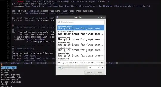

16
If you want to use a GUI font picker with previews and all, you may use M-x menu-set-font
Emacs pick a font
xandfury
  • 645
    Thanks, this should be the only recommended answer, here, on the wiki page, on the Aquamacs home page! – agam Feb 28 '18 at 18:00
    How do you make this permanent? – smonff Jun 21 '19 at 07:51
    @smonff (set-frame-font "Monospace 18") does the trick. If you look up the help for menu-set-font via C-h f you can step through the function and see this is what it ultimately calls – Will Ayd Feb 01 '23 at 18:45
