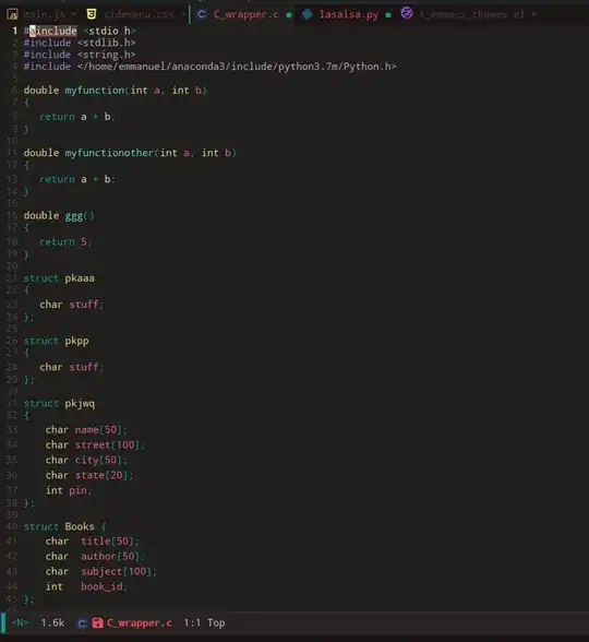

    Now its bit more close in look, using tabbar-ruler but still needs lots of changes and tweaks. enter image description here – rho Jan 14 '16 at 17:34

How about my plugin, centaur-tabs? It has a lot of configuration options, it's really functional, it is supported by very popular themes like Kaolin Themes and overall is a really nice looking and aesthetic package (according to user's feedback). It's available in MELPA and it looks like this:
  • This seems to be yet another "each tab represents a buffer and each window has its own tabbar" non-solution. – Stefan Jul 05 '19 at 13:03
  • I just added a customization to show tabs groups instead of tab names so in a function you establish rules (i.e. group elisp and lisp in one group, group c and c++ in another and so on) and in the tabs those groups are showed. – Emmanuel Bustos Jul 08 '19 at 04:21
    It's still doesn't answer the question, where there should be one tabbar per frame (rather than per window) and each tab represents a window-configuration. – Stefan Jul 08 '19 at 14:55
    Ok I didn't undestand. I'll investigate and work on it! – Emmanuel Bustos Jul 08 '19 at 15:57
  • @EmmanuelBustos Where can I find your plugin to try it out? – Eduardo Apr 13 '20 at 18:30
    @Eduardo It's on MELPA! Look For centaur-tabs in Github for the installation instructions. – Emmanuel Bustos Apr 14 '20 at 19:23
