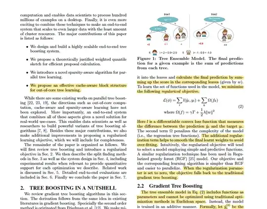

I am writing an academic paper on the application of Machine Learning methods to Time Series Forecasting and I am unsure about how to write down the theoretical part about the regularized objective function for XGBoosting. Below you can find the equation given by the developers of the XGB algorithm for the regularized objective function (equation 2). The paper is called "XGBoost: A Scalable Tree Boosting System" by Chen & Guestrin (2016). In the Python API from the xgb library there is a way to end up with a reg_lambda parameter (L2 regularization parameter; Ridge regression equivalent) and a reg_alpha parameter (L1 regularization parameter; Lasso regression equivalent). And I am a bit confused about the way the authors set up the regularized objective function. According to my understanding the ridge penalty is given by $\lambda \sum_{j=1}^p \beta_j^2$ and the lasso penalty is given by $\lambda \sum_{j=1}^p |\beta_j|$. However, the authors of the paper seem to use a combination of the two things that is not equivalent to either one since they apply the absolute value and square the beta term.

Regularized Objective function XGB

For question (a), it should be as simple as adding the usual L1 penalty: $$\begin{align*} \Omega(f) &= \gamma T + \alpha \|w\|_1 + \frac12\lambda\|w\|_2^2 \\ &= \gamma T + \alpha \sum |w_i| + \frac12\lambda \sum w_i^2 \end{align*}$$
