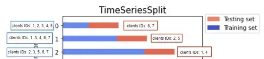

As a first porint, when you say "The idea is that this model is deployed and used to model new customers" I guess you mean and used to infere on new customers, is it correct? I can think of two possible options:
  1. following the properties you impose, you can first make use of the TimeSeriesSplit cross-validator by scikit-learn, with wich you get the time-ordered indices of each train-validation split, so that you can use them later on the clients IDs you decide to fulfill the second condition, something like: enter image description here
  2. As a second option, you could try to apply clustering on your clients, based on certain features, and build as many models as clients types you get (each cluster having n clients history data). This would solve a possible problem I see in your approach, which is (due to the second restriction) not using a client whole history data both for training and validating

  • hmm I would prefer not to use clustering or anything fancy. I don't understand how to choose the client ids in an algorithmic way, have you thought of it? – David Masip Jul 30 '20 at 07:56
  • yup, infere on new customers – David Masip Jul 30 '20 at 07:57
  • The way I thought is clustering to find similar clients (if you do not want clustering maybe you can apply an ad-hoc similarity rule among clients); this way, it woud ensure in each train-test split validation that similar clients are used to train and validate (again, based on your second restriction) – German C M Jul 30 '20 at 08:11

This feature was requested on scikit-learn and I have added a PR for it . The code is awaiting review at this point. This code was used with some good results on a recent Kaggle competition .
from sklearn.model_selection._split import _BaseKFold, indexable, _num_samples
from sklearn.utils.validation import _deprecate_positional_args
https://github.com/getgaurav2/scikit-learn/blob/d4a3af5cc9da3a76f0266932644b884c99724c57/sklearn/model_selection/_split.py#L2243
class GroupTimeSeriesSplit(_BaseKFold): """Time Series cross-validator variant with non-overlapping groups. Provides train/test indices to split time series data samples that are observed at fixed time intervals according to a third-party provided group. In each split, test indices must be higher than before, and thus shuffling in cross validator is inappropriate. This cross-validation object is a variation of :class:KFold. In the kth split, it returns first k folds as train set and the (k+1)th fold as test set. The same group will not appear in two different folds (the number of distinct groups has to be at least equal to the number of folds). Note that unlike standard cross-validation methods, successive training sets are supersets of those that come before them. Read more in the :ref:User Guide &lt;cross_validation&gt;. Parameters ---------- n_splits : int, default=5 Number of splits. Must be at least 2. max_train_size : int, default=None Maximum size for a single training set. Examples -------- >>> import numpy as np >>> from sklearn.model_selection import GroupTimeSeriesSplit >>> groups = np.array(['a', 'a', 'a', 'a', 'a', 'a',
'b', 'b', 'b', 'b', 'b',
'c', 'c', 'c', 'c',
'd', 'd', 'd']) >>> gtss = GroupTimeSeriesSplit(n_splits=3) >>> for train_idx, test_idx in gtss.split(groups, groups=groups): ... print("TRAIN:", train_idx, "TEST:", test_idx) ... print("TRAIN GROUP:", groups[train_idx],
"TEST GROUP:", groups[test_idx]) TRAIN: [0, 1, 2, 3, 4, 5] TEST: [6, 7, 8, 9, 10] TRAIN GROUP: ['a' 'a' 'a' 'a' 'a' 'a']
TEST GROUP: ['b' 'b' 'b' 'b' 'b'] TRAIN: [0, 1, 2, 3, 4, 5, 6, 7, 8, 9, 10] TEST: [11, 12, 13, 14] TRAIN GROUP: ['a' 'a' 'a' 'a' 'a' 'a' 'b' 'b' 'b' 'b' 'b']
TEST GROUP: ['c' 'c' 'c' 'c'] TRAIN: [0, 1, 2, 3, 4, 5, 6, 7, 8, 9, 10, 11, 12, 13, 14]
TEST: [15, 16, 17] TRAIN GROUP: ['a' 'a' 'a' 'a' 'a' 'a' 'b' 'b' 'b' 'b' 'b' 'c' 'c' 'c' 'c']
TEST GROUP: ['d' 'd' 'd'] """ @_deprecate_positional_args def init(self, n_splits=5, *, max_train_size=None ): super().init(n_splits, shuffle=False, random_state=None) self.max_train_size = max_train_size
