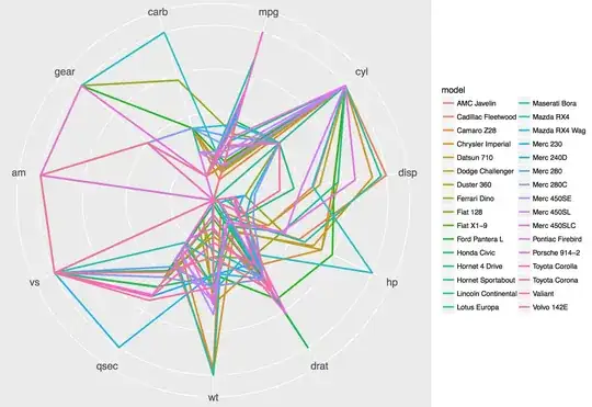

Here is an R version:
The codes here seem outdated for ggplot2: 2.0.0
Try my package zmisc: devtools:install_github("jerryzhujian9/ezmisc")
After you install it, you will be able to run:
df = mtcars
df$model = rownames(mtcars)
ez.radarmap(df, "model", stats="mean", lwd=1, angle=0, fontsize=0.6, facet=T, facetfontsize=1, color=id, linetype=NULL)
ez.radarmap(df, "model", stats="none", lwd=1, angle=0, fontsize=1.5, facet=F, facetfontsize=1, color=id, linetype=NULL)
The main codes were adapted from http://www.cmap.polytechnique.fr/~lepennec/R/Radar/RadarAndParallelPlots.html
Jerry T
