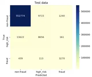

If all the classes are equally important, then it's a multiclassification problem. The confusion matrix would be n by n.
Below is a 3 by 3 example, your case would be something similar but 4 by 4.
CM for multi
As to the F1 score for multiclassification, you could use classification_report() from scikit-learn.
from sklearn.metrics import classification_report
print(classification_report(new_y_test,new_y_test_pred))
The output would be something like this, again, for your case imagine there is a class 3
              precision    recall  f1-score   support
           0       0.98      0.98      0.98    563729
           1       0.47      0.39      0.42     22439
           2       0.70      0.86      0.77      3822
    accuracy                           0.96    589990
   macro avg       0.71      0.74      0.72    589990
weighted avg       0.95      0.96      0.96    589990
