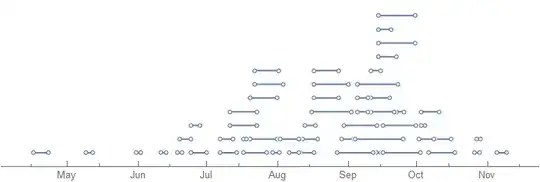

A basic TimelinePlot of timeIntervals gives
TimelinePlot[timeIntervals]
Mathematica graphics
However, TimelinePlot has many options to customise it. For example, take timeIntervals, GatherBy "Month", SortBy the first date of first interval in each set (see Part), and add an Automatic LineLegend using the "MonthShortName"s of each set as legend keys.
With[{
  byMonth =
   SortBy[#[[1, 1, 1]] &]@GatherBy[timeIntervals, DateValue[#[[1, 1]], "Month"] &]
 TimelinePlot[
  byMonth,
  PlotLegends ->
   LineLegend[Automatic, DateValue[#[[1, 1, 1]], "MonthNameShort"] & /@ byMonth]
