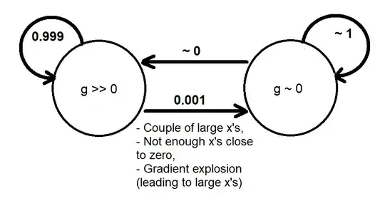

One way street analogy
Based on the previous analyses, I could provide a qualitative analogy using a Markov Chain of two states $[g \gg 0]$ and $[g \sim 0]$ that crudely models the dynamical behavior of gradient $g$ as follows
When system goes to state $[g \sim 0]$, there is not much gradient to bring (change) the values back to state $[g \gg 0]$. This is similar to a one way street that will be passed eventually if we give it enough time (large enough epochs) given convergence of training does not happen (otherwise, we have found a solution before experiencing a vanishing gradient).
A more advanced analysis of dynamical behavior of gradient would be possible by carrying out a simulation on actual neural networks (which potentially depends on many parameters such as loss function, width and depth of network, and data distribution) and come up with
