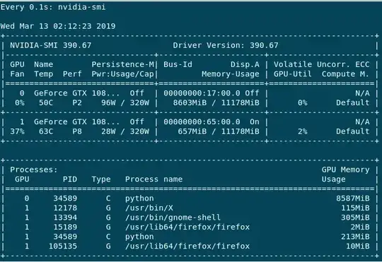

The training is very slow which I understand is down to the batch size (correct me if I am wrong). If I do help -n 1 nvidia-smi, I get the following output:
The GPU:0 is mainly used, as the Volatile GPU-Util gives me around 0%-65% whereas GPU:1 is always 0%-3% max. Performance for GPU:0 is always in P2 whereas GPU:1 is mostly P8 or sometimes P2. I have the following questions.
  1. Why I am getting an OOM error on the large batch size although my dataset and model are not that big?
  2. How can I utilize both GPUs equally in TensorFlow so that the performance is fast? (From the above error, it looks like GPU:0 gets full immediately whereas GPU:1 is not fully utilized. It is my understanding only).

  1. Why I am getting OOM error on the large batch size although my dataset and model are not that big?
Yes, the batch size is probably the reason.
Also, another the reason is that you don't use the second GPU at all (otherwise, both GPUs will split the batch - computation - and you could use larger batches).
  1. How can I utilize both GPU's equally in Tensorflow so that the performance is fast? (From the above error, it looks like GPU:0 gets full immediately whereas GPU:1 is not fully utilized. it's my understanding only)
By default, Tensorflow occupies all available GPUs (that's way you see it with nvidia-smi - you have a process 34589 which took both GPUs), but, unless you specify in the code to actually use multi GPUs, it will use only one by default.
Here is an official TF docs about how to use multi GPUs: https://www.tensorflow.org/guide/using_gpu#using_multiple_gpus https://www.tensorflow.org/guide/gpu#using_multiple_gpus
Here is some tutorial for multi-gpu usage with more examples: https://jhui.github.io/2017/03/07/TensorFlow-GPU/

  • Thank you for this detail explanation I will definitely set up multiple GPUs manually. Just one last thing, what do you mean by "some extra preprocessing/postprocessing in the graph and so on ..." Can you please give me a little overview? – Ammar Ul Hassan Mar 14 '19 at 15:00
  • Since that thing is little out of scope here, I updated the answer and removed that part. The "batch size" reason will be enough here. :) – Antonio Jurić Mar 14 '19 at 15:28
