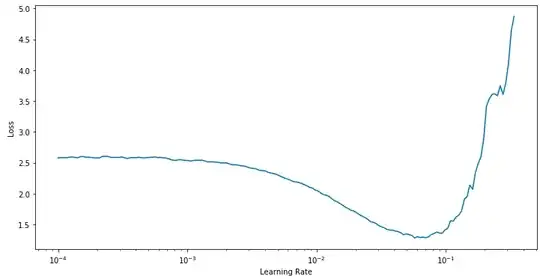

Try using a Learning Rate Finder. Here's an implementation for Keras: https://github.com/WittmannF/LRFinder
You basically have to plot the loss against different learning rates. The steepest area is the best choice of LR. Here's an example:
from keras.models import Sequential
from keras.layers import Flatten, Dense
from keras.datasets import fashion_mnist
!git clone https://github.com/WittmannF/LRFinder.git
from LRFinder.keras_callback import LRFinder
# 1. Input Data
(X_train, y_train), (X_test, y_test) = fashion_mnist.load_data()
mean, std = X_train.mean(), X_train.std()
X_train, X_test = (X_train-mean)/std, (X_test-mean)/std
# 2. Define and Compile Model
model = Sequential([Flatten(),
                    Dense(512, activation='relu'),
                    Dense(10, activation='softmax')])
model.compile(loss='sparse_categorical_crossentropy', \
              metrics=['accuracy'], optimizer='sgd')
# 3. Fit using Callback
lr_finder = LRFinder(min_lr=1e-4, max_lr=1)
model.fit(X_train, y_train, batch_size=128, callbacks=[lr_finder], epochs=2)
In the above example, the best learning rate is about 2e-2. This has been popularized by FastAI. Here's an article with more info: https://medium.com/octavian-ai/how-to-use-the-learning-rate-finder-in-tensorflow-126210de9489
