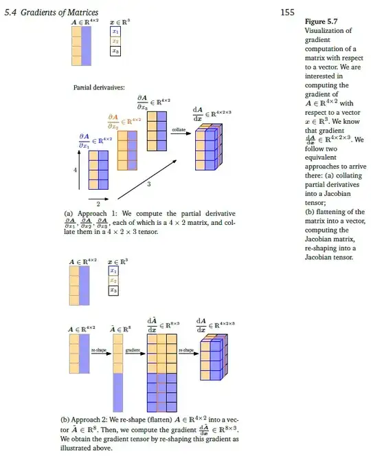

Matrix
To handle the mini batch, need to handle the back propagation as Jacobian products. SeeProduct of Jacobians and chain Rule. Mathematics for Machine Learning 5.4 Gradients of Matrices has further explanations.
dL/dW.T
To calculate the impact of the changes in W.T on the total loss L of the neural network. Using the row-order matrix in the diagram.
The deduction will result in a different formula depending on what order of the matrix to use in X, W, and Jacobian, and how to organize weights in W. Andrew Ng used row-order and per-node weight grouping in Theta or W in his ML course at Coursera. CS231 of Stanford University by Justin Johnson used different weight grouping in W.
