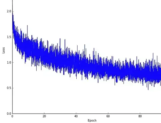

One perhaps downside, is that the path to the optimum (assuming it would always be the same optimum) can be much noisier. So instead of a nice smooth loss curve, showing how the error descreases in each iteration of gradient descent, you might see something like this:
noisy loss curve
We clearly see the loss decreasing over time, however there are large variations from epoch to epoch (training batch to training batch), so the curve is noisy.
This is simply because we compute the mean error over our stochastically/randomly selected subset, from the entire dataset, in each iteration. Some samples will produce high error, some low. So the average can vary, depending on which samples we randomly used for one iteration of gradient descent.
