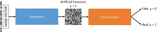

Training the generator
When we train the generator we will keep the discriminator fixed, this is necessary as to not saturate our parameters and make the discriminator too strong to ever beat. So what we essentially have is a CNN (the generator) connected to another CNN (the discriminator). The connecting nodes between these two models is going to be output which will generate the desired images once trained. Do note that the generator wants the instances it will produce in this case to be classified by the discriminator as being from the real distribution, so they will have labels $y = 1$.
All together this is just a CNN and the backpropagation will be computed in the exact same way. First we pass through a noise vector, it goes through the generator, some random image gets produced at its output, that then goes through the discriminator and gets classified as $artificial$. But, we are expecting the discriminator to be fooled in this case, so this is an error, it should have been labeled as $real$. We then use backpropagation to get the error contribution of each model parameter. We will then use gradient descent to update all the parameters associated with the generator.

Finally, in order to train the generator, just imagine the same process with more convolutional layers ahead of it. When we have the associated gradient $\nabla L(w)$ for each parameters, only apply the gradient descent algorithm to the parameters that are a part of the generator model. I am sure that through these derivations you will see that the number of intermediate nodes between layers does not affect the backpropagation algorithm. It remains the same process. You should also be convinced that for a non-human the intermediate nodes that are the generated image from the GAN, are no different from any intermediate nodes in the model. We simply train these intermediate nodes in such a way that we can perceive some meaning, such as generating instances of the MNIST dataset.
