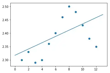

In this case your feature matrix $X$ has a single dimension. Each point in your graph has a $y$ value that depends only on 1 value of $x$.
Ok let's go through the code
x=[1,2,3,4,5,6,7,8,9,10,11,12]
y=[2.3,2.33,2.29,2.3,2.36,2.4,2.46,2.5,2.48,2.43,2.38,2.35]
Let's convert these to matrices. We will also add a column of 1's to the end of the $X$ matrix. This will be used to train the bias value.
temp = np.ones((len(x), 2))
temp[:,0] = np.asarray(x)
x = temp
y = np.asarray(y)
Now we will calculate our weights as
$w = (X^TX)^{-1}X^Ty$
w = np.matmul(np.matmul(np.linalg.inv(np.matmul(np.transpose(x), x)), np.transpose(x)), y)
array([ 0.01174825, 2.30530303])
Look at the dimensions of our weights vector. It only has 2 values. One value associated with $x$, the first column of our $X$ matrix, and a bias, associated with the 1's column that we added. The equation of this line is described as
$y = 0.01174825 x_1 + 2.30530303$
We can see that this line indeed describes the data pretty well for a linear regression.
