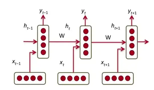

Most LSTM/RNN diagrams just show the hidden cells but never the units of those cells. Hence, the confusion. Each hidden layer has hidden cells, as many as the number of time steps. And further, each hidden cell is made up of multiple hidden units, like in the diagram below. Therefore, the dimensionality of a hidden layer matrix in RNN is (number of time steps, number of hidden units).

As the helpful comments in that function say,
The definition of cell in this package differs from the definition used in the literature. In the literature, cell refers to an object with a single scalar output. The definition in this package refers to a horizontal array of such units.
In essence, the layer will contain multiple parallel LSTM units, structurally identical but each eventually "learning to remember" some different thing.
