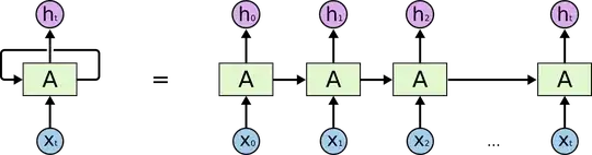

Let's say you have time-series data with $N$ rows and $700$ columns which you want to feed to a SimpleRNN(200, return_sequence=True) layer in Keras. Before you feed that to the RNN, you need to reshape the previous data to a 3D tensor. So it becomes a $N \times 700 \times 1$.
unrolled RNN
The image is taken from https://colah.github.io/posts/2015-08-Understanding-LSTMs
In RNN, your columns (the "700 columns") is the timesteps of RNN. Your data is processed from $t=1 \ to \ 700$. After feeding the data to the RNN, now it have 700 outputs which are $h_1$ to $h_{700}$, not $h_1$ to $h_{200}$. Remember that now the shape of your data is $N \times 700 \times 200$ which is samples (the rows) x timesteps (the columns) x channels.
And then, when you apply a TimeDistributedDense, you're applying a Dense layer on each timestep, which means you're applying a Dense layer on each $h_1$, $h_2$,...,$h_t$ respectively. Which means: actually you're applying the fully-connected operation on each of its channels (the "200" one) respectively, from $h_1$ to $h_{700}$. The 1st "$1 \times 1 \times 200$" until the 700th "$1 \times 1 \times 200$".
Why are we doing this? Because you don't want to flatten the RNN output.
Why not flattening the RNN output? Because you want to keep each timestep values separate.
Why keep each timestep values separate? Because:
  • you're only want to interacting the values between its own timestep
  • you don't want to have a random interaction between different timesteps and channels.
