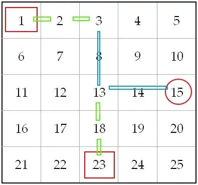

Consider a grid with $x=5$ columns, $y=5$ rows, and $T$ timesteps.
grid
There are $N=2$ agents in this grid, which can move vertically or horizontally. The positions of each agent $x$ at timestep $t$ is denoted as $A_{xt}$. For this example, consider $A_{00}=1$ and $A_{10}=23$. The goal is to carry a ball from node $1$ to node $G=15$. Each agent can carry the ball or throw it at distance $k=2$ (measured in Manhattan distance). The shortest path is, in this case, for Agent $0$ to carry the ball until node $3$, while Agent $1$ moves to node $13$. Then, Agent $0$ throws the ball to Agent $1$, which kicks it to the goal node.
grid2
How can this be modeled? If agents cannot move without the ball (not a dynamic graph), the problem is fairly simple. Assume $X_{ijt}=1$ (an activated edge) when the ball is carried or is kicked from node $i$ to $j$ at timestep $t$, and all actions cost (or have weight) $1$. All nodes (except starting and goal nodes) must have the same amount of ball 'entrances' as 'exits'.
$ \sum X_{ijt_1} = \sum X_{jit_2}, \forall i,j,t_1,t_2$, where $t_1<t_2, d(i,j)=1$ (adjacent nodes) or $j=A_{xt}$ (passing towards an agent)
The entrance and exit nodes will have a single activated edge.
$ \sum X_{A_{00}j0} + \sum X_{A_{00}A_{x0}0} = 1, \forall j,x$, where $x\neq0, d(A_{00},j)=1, d(A_{00},A_{X0})\leq k$
$ \sum X_{iGT} = 1, \forall i$, where $d(i,G)\leq k$
However, if all agents can move at any given point, then the graph is dynamic, since the passes that can be performed are different in each timestep. I don't know how to model this. Before, because $A_{1t}$ was static until it got the ball, I could list all the restrictions a priori, but now, I cannot do it. I can create a set of restrictions based on $A_{xt} \forall x,t$, but I don't know how to then input this problem into a linear programming solver (for example, a simplex method).
