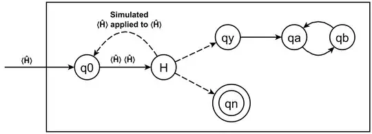

Applying a Simulating Halt Decider to the Linz Halting Problem Proof
A simulating (at least partial) halt decider correctly predicts whether or not its correctly simulated input can possibly reach its own final state and halt. It does this by correctly recognizing several non-halting behavior patterns in a finite number of steps of correct simulation. Inputs that do terminate are simply simulated until they complete.
The Linz text indicates that Ĥ is defined on the basis of prepending and appending states to the original Linz H, (assumed halt decider) thus is named embedded_H.
(q0) is prepended to H to copy the ⟨Ĥ⟩ input of Ĥ. The transition from (qa) to (qb) is the conventional infinite loop appended to the (qy) accept state of embedded_H. ⊢* indicates an arbitrary number of moves.
The Linz term “move” means a state transition and its corresponding tape head action {move_left, move_right, read, write}. Ĥ is applied to its own machine description ⟨Ĥ⟩.
Ĥ.q0 ⟨Ĥ⟩ ⊢* embedded_H ⟨Ĥ⟩ ⟨Ĥ⟩ ⊢* Ĥ.qy ∞
Ĥ.q0 ⟨Ĥ⟩ ⊢* embedded_H ⟨Ĥ⟩ ⟨Ĥ⟩ ⊢* Ĥ.qn
When Ĥ is applied to ⟨Ĥ⟩
(q0) The input ⟨Ĥ⟩ is copied then transitions to (qx)
(qx) embedded_H is applied to ⟨Ĥ⟩ ⟨Ĥ⟩ (input and copy)
which simulates ⟨Ĥ⟩ applied to ⟨Ĥ⟩ which begins at its own (q0) to repeat the process.
This process continues to repeat until embedded_H recognizes the repeating pattern and aborts its simulation of ⟨Ĥ⟩ ⟨Ĥ⟩. embedded_H can see the same repeating pattern that we see.
computation that halts… “the Turing machine will halt whenever it enters a final state” (Linz:1990:234)
Every "rebuttal" simply ignores this key fact
⟨Ĥ⟩ ⟨Ĥ⟩ correctly simulated by embedded_H cannot possibly reach its own simulated final state of ⟨Ĥ.qn⟩ and halt in any finite number of steps of correct simulation.
Linz, Peter 1990. An Introduction to Formal Languages and Automata. Lexington/Toronto: D. C. Heath and Company. (317-320)

Your question is: What happens when you use a simulating halt decider and (...)?
The answer is: You can't. The question has a faulty premise. A simulating halt decider does not exist, so there is no meaningful answer to the question.
I'll highlight your definition. You propose the following definition:
A simulating (at least partial) halt decider H is a UTM that has been adapted to decide whether or not its input halts. It does this by simulating its input and examining the behavior of this simulated input.
(I presume this should be interpreted as saying that, to count as a simulating halt decider, the UTM must always correctly decide whether or not its input halts, for all possible inputs.)
The problem is: there does not exist any UTM that successfully acts as a simulating halt decider on all inputs.
You can add all the conditions and requirements you want to a definition. The definition remains valid. But there is no guarantee that there exists any object that meets the conditions of the definition. That has to be separately verified.
It sounds like you think that there does exist such a UTM that would qualify as a simulating halt decider. However, your intuition is faulty. I know it's easy to identify some patterns that, if they arise during execution, allow us to determine whether the input will halt. However, those patterns will never be comprehensive. No matter how many patterns you write down, there will always be some inputs that aren't handled by any of those patterns.
Those of us who have studied complexity theory already know this, because there is a theorem that proves it. High-level statements such as "Certain patterns of behavior such as infinite loops and infinite recursion can be recognized." is not likely to be effective at persuading anyone to the contrary, because we know there are also other kinds of behavior that won't be recognized; yet such language is too vague and imprecise to allow us to give you specific examples to help you see that fact concretely.
If you'd like to pump your intuition, you can find some examples of programs where no one knows whether they halt or not: What are the simplest examples of programs that we do not know whether they terminate?, What are very short programs with unknown halting status?. If you study them, perhaps it will give you a better sense why these programs might fail to halt (they might run forever) without ever entering any loop, or even matching "pattern" that you can write down. (More specifically, for any pattern or list of patterns you have in mind, there might be some input that fails to halt but doesn't match any of those patterns.)

In response to an earlier version:
You have misunderstood their proof, which is not very well presented (imho); but you also seem to have cut off the end, where they establish the contradiction.
They do not state anywhere that $M$ is simulated, at all.
$\hat H$ simulates $H'$ and $H'$ simulates $H$. Now, $H$ is assumed -- towards a contradiction -- to be decider. which means it always terminates after finitely many steps. No assumption is made on how it solves the halting problem -- which is the point, of course, because only so can be disprove all candidates for $H$ by leading the assumption to a contradiction!
So we simulate $H$ which always terminates -- no infinitely nested simulation is happening.
Your intuition is not wrong, though, even though you seem to be missing the corner cases: you'd need something like "infinitely nested simulation" to solve the halting problem -- something that doesn't work. Because it's impossible.
When we hypothesize that the halt decider embedded in Ĥ is simply a Universal Turing Machine (UTM) does this define a computation that never halts when Ĥ is applied to its own Turing machine description?
There are infinitely many UTMs. Without further assumptions, we just don't know what any arbitrary one of those does on its own encoding.
Raphael

  • A simulating (at least partial) halt decider does correctly decide that Ĥ applied to its own Turing machine description correctly decides that its input would not halt (see Figure 12.4 above). It is simpler to use my notational conventions where Ĥ is a single machine with named internal states. Simpler notational conventions prevent confusion. – polcott Jun 07 '21 at 21:51
  • "They do not state anywhere that M is simulated, at all." The proof leaves open how H is defined when it specifies the ⊢* wildcard state transitions. We analyze the behavior of Ĥ applied to its own Turing machine description ŵ. When the embedded halt decider bases its decision on simulating its input an infinitely repeating pattern is derived. When computations have Infinitely repeating patterns we know that these computations never halt. – polcott Jun 07 '21 at 22:42
    @polcott You don't get to make assumptions on how H works. – Raphael Jun 08 '21 at 00:01
  • Yes you do that is what the ⊢* wildcard state transition encoding means. One is free to define H in an unlimited number of different ways including defining H on the basis of a UTM. – polcott Jun 08 '21 at 00:08
    No: https://cs.stackexchange.com/questions/141080/what-happens-when-the-peter-linz-h-is-a-simulating-halt-decider-and-%c4%a4-is-applied/141115?noredirect=1#comment297264_141115 Hard as it is, at some point you'll have to reconsider the idea that you acually haven't understood the proof. – Raphael Jun 08 '21 at 08:35
  • I spent 12,000 hours on this and you only spent about 20 minutes. I spent 3000 hours making an actual halt decider and the x86utm operating system that implements the Linz H_Hat showing exactly how it decides that its input is not a halting computation when it is applied to itself. To understand what I am saying you must do much more than glance at a few of my words before forming your rebuttal. – polcott Jun 08 '21 at 13:19
  • I had daily reviews from several reviewers for six months none of them ever found any actual error. – polcott Jun 08 '21 at 13:31
    There is no material here to spend more time on. I'm sorry you wasted all that time. – Raphael Jun 08 '21 at 13:56
    By the way: even if you managed to come up with some machine that can solve its own halting problem, that does not solve the halting problem. – Raphael Jun 08 '21 at 13:57
  • Yes I know that. My maximum scope is to refute all the conventional halting problem proofs. – polcott Jun 08 '21 at 13:58
  • "So we simulate H which always terminates -- no infinitely nested simulation is happening." Not at all. When H recognizes what would be infinitely nested simulation it aborts its simulation of this input and halts. – polcott Jun 08 '21 at 21:25
    @polcott Does this help? https://cs.stackexchange.com/a/112230/1329 – Andrej Bauer Jun 09 '21 at 07:17
    "When H recognizes what would be infinitely nested simulation it aborts its simulation of this input and halts" -- No. You don't know anything about H. – Raphael Jun 09 '21 at 20:28
  • I have finally simplified the question enough that it can be properly answered. Your answer no longer applies to this simplified question. – polcott Jun 10 '21 at 14:40
  • It turns out that the input only contradicts its own internal termination analyzer and does not contradict the external H. – polcott Mar 06 '24 at 01:01
Refutation of the Peter Linz Halting Problem proof
The following shows how Linz H ⟨Ĥ⟩ ⟨Ĥ⟩ gets the right answer because Linz Ĥ.H ⟨Ĥ⟩ ⟨Ĥ⟩ gets the wrong answer
H ⟨Ĥ⟩ ⟨Ĥ⟩ ⊢* H.qy // Ĥ applied to ⟨Ĥ⟩ halts
H ⟨Ĥ⟩ ⟨Ĥ⟩ ⊢* H.qn // Ĥ applied to ⟨Ĥ⟩ does not halt
Criterion Measure
H is assumed to be a simulating termination analyzer that aborts the simulation of any input that would cause its own non-termination and returns NO. Otherwise H always returns YES.
Ĥ.q0 ⟨Ĥ⟩ ⊢* Ĥ.Hq0 ⟨Ĥ⟩ ⟨Ĥ⟩ ⊢* Ĥ.Hqy ∞ // Ĥ applied to ⟨Ĥ⟩ halts
Ĥ.q0 ⟨Ĥ⟩ ⊢* Ĥ.Hq0 ⟨Ĥ⟩ ⟨Ĥ⟩ ⊢* Ĥ.Hqn // Ĥ applied to ⟨Ĥ⟩ does not halt
Execution trace of Ĥ applied to ⟨Ĥ⟩
(a) Ĥ.q0 The input ⟨Ĥ⟩ is copied then transitions to Ĥ.H
(b) Ĥ.H applied ⟨Ĥ⟩ ⟨Ĥ⟩ (input and copy) simulates ⟨Ĥ⟩ applied to ⟨Ĥ⟩
(c) which begins at its own simulated ⟨Ĥ.q0⟩ to repeat the process
Same execution trace even when infinite loop is removed
It is true that Ĥ.H ⟨Ĥ⟩ ⟨Ĥ⟩ must transition to Ĥ.Hqn to prevent its own infinite execution. It is true that this makes Ĥ ⟨Ĥ⟩ halt. This entails that H ⟨Ĥ⟩ ⟨Ĥ⟩ would be correct to transition to H.qy.
When Ĥ.H ⟨Ĥ⟩ ⟨Ĥ⟩ and H ⟨Ĥ⟩ ⟨Ĥ⟩ correctly apply the above criteria then Ĥ.H ⟨Ĥ⟩ ⟨Ĥ⟩ would transition to Ĥ.Hqn and H ⟨Ĥ⟩ ⟨Ĥ⟩ would transition to H.qy
No one has refuted any of the above reasoning
