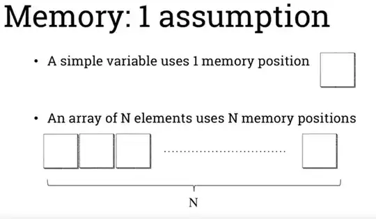

My lecturer says that a variable takes up one memory position in RAM. This is the slide in question:
But CLRS (Introduction to Algorithms by Cormen, end of page 23) says an integer is represented by $c\ lg\ n$.
Are both statements true? How can that be?

    @Bee both your professor and the CLRS text is correct. Although others have written wonderfully nice answers, I felt like explaining in an alternate manner. See the term memory position used by your professor has no units specified explicitly, but intuitively by using the common meaning, it can thought as memory word which is actually measured in bits. In real world computers all the data types like int, float, double have a fixed data size and as such the bits required to store them are constant and taking this constant number of bits as a memory position, your professor explains. – Abhishek Ghosh Apr 18 '21 at 21:13
    @Bee, while CLRS being mostly a mathematics books and to make things more generalized, it does not assume any limits on the size of n. So it states that to store an integer of size n we need $\Theta(\lg n)$ no. of bits. Note the units, and the concept that here the size of the bits required to represent an integer is not bounded , rather it is allowed to be variable with respect to n – Abhishek Ghosh Apr 18 '21 at 21:15

The random-access machine is a common model of computation, which is the model of choice when analyzing algorithms. In this model, memory consists of words of length $\Theta(\log n)$ bits, where $n$ is the length of the input (in bits). Therefore both your lecturer and CLRS are right.

In practical computer machines (aka, real-world computers) variables can be considered to be stored in "one" memory position, since the variable's size is fixed beforehand. For example, int is usually 32 bit long, and hence we can say it takes up "one" memory position of length 32 bits.
However, in the theoretical terms, integers do not have to be bounded between some arbitrary values we defined beforehand. That is, in the practical world integer with size 32 bit cannot store a value larger than $2^{32}-1$, but in the theoretical model it can. The caveat here, is that since we do not restrict the value of a variable, we need to actually consider how much memory it eats up. To save the number $n$ we need $\log(n)$ bits, hence what the book says is true, in the theoretical model.

In mathematics, an integer can get arbitrarily big. However, the bigger a number, the more digits are needed to write it down.
A memory cell in a computer has finite capacity. Therefore, a single cell can only store integers up to a certain size.
A single variable, stored in a single memory cell, can therefore hold integers only up to a certain size. That's why most programming languages limit the size of their integral data types. For instance, in Java, a variable of type int can hold integers up to $2^{31}$ (about 2 billion).
That is, the word "integer" means something slightly different in mathematics and programming. CLRS was talking about the mathematical integers, while your professor was talking about the integral data types provided by a computer. The former may get arbitrarily big, and require many memory cells, while the latter fit within a cell by definition.

Integers take up logarithmic space but this is usually of little interest during algorithmic analysis of real-world problems.

A variable refers to exactly one memory position, where "one memory position" is typically 64 bits on a modern computer.
When you want to store something bigger in a variable, you store a reference to the value in the original memory position. This reference can be used to find a sequence of memory positions that contain the actual value.
These extra memory positions do not belong to the variable, but to the value stored.
