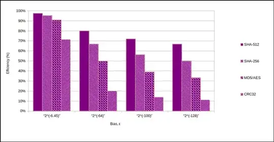

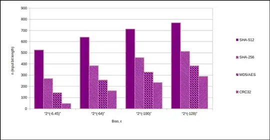

So post extraction, a weakly random source seems to emerge with much better randomness, and a bias away from perfection bounded by the Leftover Hash Lemma:-
$$ \epsilon = 2^{-(sn-k)/2} $$
where we have $n$ = input bits at $s$ bits/bit of raw entropy from the source, $k$ is the number of output bits from the extractor (and $<n$). $\epsilon$ is the bias away from a perfectly uniform $k$ bit length string, i.e. $H(k) = 1 - \epsilon$ bits/bit. NIST accepts that $\epsilon < 2^{-64}$ for cryptographic applications.
However, $\epsilon$ can easily be made much smaller. I aim for $2^{-128}$. For the extractor you could use SHA-512 ($k=512$) to minimize entropy loss. You can see the $n/k$ ratios and relative efficiencies in these charts:-
chart1
chart2
So in conclusion, you don't need/shouldn't use a PRNG atop your entropy source. If you're making a TRNG, make it a proper TRNG. Speed isn't all that important.
