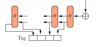

The reason is clear. Argon2 returns return Hash(C, tagLength) (variable-length hash function) or see from Argon2 paper page 6 *
And if BLAKE2 is used then the first 64 byte is the output of the BLAKE2. If the output requirement is > 64 bytes, then the remaining bytes are derived from the output of the previous BLAKE2 calls.
   V1 ← Blake2b(digestSize ∥ FinalBlock, 64);
   Subsequent blocks are generated from previous blocks
   for i ← 2 to r do
      Vi ← Blake2b(Vi-1, 64)
   Lower 32 bytes of Vi is returned.
Therefore one cannot have security larger than the hash digest size and this should be enough for even post-quantum adversaries.
