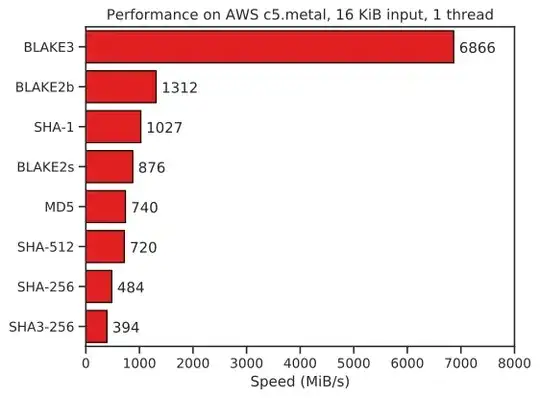

If one wants to have a faster mining system then the obvious choice is BLAKE3 and it is length extension attack free by design. Though BLAKE3 is a parallel hash, the performance is given on a single thread on the website of the BLAKE3.

Note by replacing SHA-256 in the Scrypt, one actually replaces PBKDF2-SHA256 to PBKDF2-BLAKE3 where PBKDF2 uses SHA-256 to initialize HMAC-SHA256. The aim of HMAC is to construct pseudo-random function families (PRFs) and this is why it is in PBKDF2. An additional speedup can be gained by running BLAKE3 with secret prefix $BLAKE3(secret\mathbin\|m)$ instead of HMAC.
