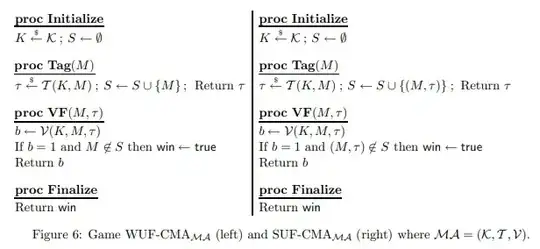

The first seminal paper to define the terms Chosen Message Attack (CMA) and existential forgery (the opposite of which is SUF and WUF) is A digital signature scheme secure against adaptive chosen-message attacks by S. Goldwasser, S. Micali, and R. L. Rivest. But the best paper to formally define SUF-CMA and WUF-CMA in the form of a game is Authenticated Encryption: Relations among notions and analysis of the generic composition paradigm by Mihir Bellare and Chanathip Namprempre. See specifically Fig. 6:
Below the figure, you'll find a very precise definition of the concept of Unforgeability.
