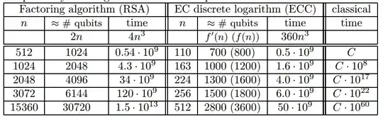

And regarding RSA, there is a paper from Proos and Zalka with estimations for RSA and ECC. See the image below extracted from the paper:
Which clarifies that you need 2048 qubits to factor a 1024 RSA key. As noted by user1147688 in a comment this paper talks about logical qubits, and specifies that:
Also it seems very probable that for large scale quantum computation error correction or full fault tolerant quantum computation techniques are necessary. Then each of our "logical" qubits has to be encoded into several physical qubits (possibly dozens) and the logical quantum gates will consist of many physical ones.
Making the target number of qubits to break RSA-1024 much higher than the theoretical 2048.

  • Just to clarify the C time values: "The column to the right roughly indicated the classical computing resources necessary in multiples of C, where C is what’s barely possible today." Since, the paper was written 2008, that means what was possible using the technology of 2008. And we're now 9 years later... – not2qubit Feb 03 '17 at 12:49
    In addition, the comments in the 2nd paper states: "Also it seems very probable that for large scale quantum computation error correction or full fault tolerant quantum computation techniques are necessary. Then each of our "logical" qubits has to be encoded into several physical qubits (possibly dozens) and the logical quantum gates will consist of many physical ones." – not2qubit Feb 03 '17 at 12:52
  • I'm going to cast doubt on those estimates of C. This paper was written in 2008. In 2005 the RSA-200 (200 decimal digits/663 binary digits) and RSA-640 numbers were factorised. In 2009 the RSA-768 number was factorised. So those estimates are way to high. – blademan9999 Jun 29 '23 at 16:07
