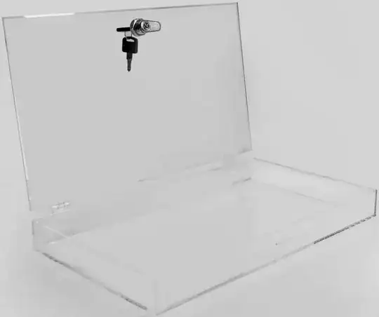

Here's another possible analogy: suppose you had an item in a clear acrylic display case that had a built-in lock, specifically one of those locks that required it to be locked with the key itself. Example:
Locking acrylic display case
Then someone without the key, upon coming across this case, could not verify that it was locked with a specific key, though they would know it was locked with some key. Someone with the "real" key could simply try to unlock the case, and if they succeeded, well, there you go.
This fits relatively well with a real MAC: the theoretical "algorithm" would be to use a case with the corresponding key(s). An attacker without the key cannot easily alter the document in question without alerting the key-bearer(s): any sort of brute-force physical attack on the case would likely leave marks on the case (e.g., saws, acid, etc.) The only exception would be lockpicking, but many physical analogues for other cryptographic primitives suffer from lockpicking too, so we'll ignore it.
There are a few inconsistencies, however: in a real cryptographic primitive, if the attacker has no knowledge of the scheme, the attacker may not necessarily know that a particular value is indeed a MAC tag. With the display case, however, it is quite clear that the document in question is protected, no matter how little an attacker knows. Further, with a real MAC, if you don't possess the key, you cannot verify the authenticity of the item in question. With the acrylic display case, you can pretty much look at it and figure out whether or not an unauthorized party has modified it: maybe someone took a bandsaw to the hinges to remove the door. That'd be pretty hard to miss.
On the other hand, as a third party looking at the display case, you don't necessarily know who have keys, so a bit of subterfuge could go unnoticed. Anyway, despite giving this matter a fair bit of thought, I have yet to come up with a better physical analogue, so take this as you will.

  • @Reid -- you have two pretty good ideas here; I wish you had posted them as two separate answers, so that the "better one" (whichever that may be) would float to the top. +1 anyway. – David Cary Jul 15 '13 at 20:40
  • +1. To make this more analogous to a real MAC, we could assume that an attacker could steal the case (and everything inside it) and substitute a similar-looking one of his one -- only someone with the "real" key would discover that it doesn't unlock the replacement case, just as only someone with the real secret key can tell that a substituted message with a substituted MAC isn't the original message. – David Cary Jul 16 '13 at 03:36

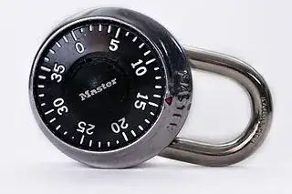

A padlock is a good analogy.
padlock
Consider a combination lock, where Alice and Bob know the secret combination. Alice can send Bob a message by writing down her message on a piece of paper, putting the piece of paper inside a metal chest, and locking the chest with the padlock. Then, Alice sends the chest by courier to Bob. Now Bob, who knows the combination, can open the combo lock and read Alice's message. No one else will be able to tamper with the message, since they don't know the combination to the lock. For example, the courier cannot tamper with the integrity of the message, since the courier doesn't know the combination. Here the secret combination plays the role of the MAC key.

  • I disagree, a MAC can only detect tampering but not prevent it - unlike the padlock. – orlp Jul 12 '13 at 19:54
  • Your transparent chest has a slit in the top, so you actually can tamper by adding more messages inside ... kinda like a length extension for a bad MAC. – Paŭlo Ebermann Jul 14 '13 at 10:36
  • @PaŭloEbermann, that was the best picture I could find. I intend the chest to have no slits, but I couldn't find a picture of such a thing. – D.W. Jul 14 '13 at 18:30
  • I replaced the image of the chest with one that has no slit. – Stephen Touset Jul 15 '13 at 23:29
  • I don't understand the transparency bit. Normally if I have a MAC I cannot determine the contents of the message by looking at the MAC (the transparent box). I could check of course if it exactly matches the plain text, but only if I have the key. Personally I think the box should be opaque. – Maarten Bodewes Jul 16 '13 at 08:45
    As I interpreted the answer, the MAC is the padlock on the box. It ensures that the message inside has not been tampered with by someone that does not possess the combination / key. Typically a MAC is sent with the data to be verified, and that data can be viewed without restriction. – Stephen Touset Jul 16 '13 at 15:43
    To be fair, I think your solution is technically slightly more accurate (there are no restrictions on modifying the contents protected by the MAC, for example). But I also appreciate the simplicity and intuitiveness that this answer provides. They're both great answers. – Stephen Touset Jul 16 '13 at 15:45
  • Ah, now I understand. But indeed with this example, anybody can see (verify) what is in the box, and nobody is able to use it unless they have the key.... That's indeed pretty different from what a MAC should be. – Maarten Bodewes Jul 16 '13 at 19:36
  • You'd have to buy a pretty expensive padlock though. They aren't exactly known for being hard to crack. – rath Jul 17 '13 at 02:08
