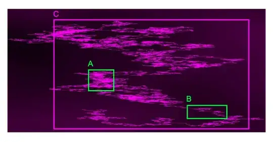

In your case (input file), a rewind is just that; start again from the beginning. Eight rewinds is good. I've seen 1849 rewinds. Honestly I can't understand the reasoning behind that, as all it does is retest what's been tested.
And that could be good or bad as is illustrated with the following walk over a random source. If you test and rewind the contents of box A you might expect a pass. Conversely if you test and rewind box B, monobit and runs tests are likely to fail due to the large 3:1 bias in the x axis. Repetitive rewinding clearly can't help the p values, so perhaps we need a larger sample size such as box C.
walk
All we know for certain is that Dieharder uses a lot. Your paper and my research shows that a free run of Dieharder (with no rewinds) needs approximately 225 - 250 GB! Notice that $58 \times 4 \text{GB}= 232 \text{GB}$.
