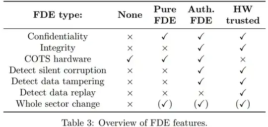

On page 3 and 4, section 2.2, "FDE Protection Types" they further detail:
  • Pure FDE - Length-preserving encryption that provides confidentiality only.
  • Authenticated FDE - Encryption that provides both confidentiality and integrity protection, but limited by COTS devices (no hardware for authentication).
  • HW-trusted - The ideal solution with confidentiality and integrity protection. It stores some additional information to external trusted storage in such a way that the system can detect data replay.
Overview of FDE Features
"Authenticated encryption enforces that a user cannot read tampered data but will see an authentication error. It not only stops any attempts to use tampered data on higher layers, but also helps a user to realize that the device is no longer trustworthy. An overview of the features among FDE types is summarized in Table 3.".

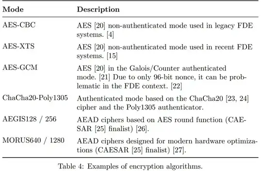

On page 5, section 3.2, "Authenticated Encryption" they continue:
"We have two options for integrity protection combined with device encryption: either to use Authenticated Encryption with Additional Data (AEAD) or to combine length-preserving encryption with an additional cryptographic integrity operation. The major difference is that for the combined mode, we can ignore integrity tags and decrypt the data without such tags. In the AEAD mode, the authentication is an integral part of decryption. Additionally, for the combined mode, we need to provide two separate keys (encryption and authentication), whereas the AEAD mode generally derives the authentication key internally. Both mentioned integrity methods calculate an authentication tag from the final ciphertext (encrypt-then-MAC).
Table 4: Examples of Encryption Algorithms
The encryption operation output consists of the encrypted data and the authentication tag. Authentication mode with additional data (AEAD) calculates the authentication tag not only from the input data but also from additional metadata, called additional authentication data (AAD). Table 4 summarizes examples of the encryption modes mentioned in this text.".
