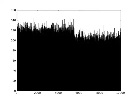

First, how not to do it. You could generate 2 bytes, treat it as a 16 bit number and compute it modulo 10000. That would give you a number between 0 and 9999, but would not be cryptographically secure. It would have bias. For example, using python random.randint(0,65535) % 10000, I generated 1,000,000 random numbers and plotted the following histogram:

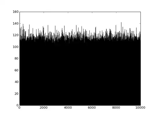

The proper way to do it would be to generate 2 random bytes and treat them as a 16 bit number, say $x$. Then compute $x' = x\mod 16384$ (note $16384 = 2^{14}$, i.e., the next power of two just bigger than 10000). Then, if $x'$ is less than 10000, return that number, otherwise start over. Using this process gives the following histogram on 1,000,000 random numbers.
