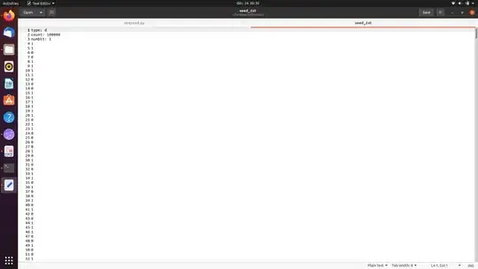

  1. Many thanks for your answe rI think it finally worked with that enter image description here
  2. just to be sure: what is d? when I looked other example I sometimes saw b instead of d
  3. I have just 0 and 1 so numbit should be 1 I guess, right?
  4. and you wrote some numbers and they are actually random numbers right? (In my case it is jut 0 and 1 instead of 3129711816 85411969 2545911541)
  5. And I want to test how much my numbers are random with this file and this code script right?
  6. Also When I tried without changing my file as a header file, it worked with this code script: dieharder -a-f your-file.txt and what does thos script mean? OK it worked but I couldnt change my file like header file and I dont know what it means

Personally I never bother with ASCII and just go binary as it's easier, but so be it. There's a lot of good stuff on this page, but in essence what you need to do is...
One.
To use it with an ascii formatted file:
 dieharder -g 202 -f your-file.txt -a
(your-file.txt should consist of a header such as:
# generator I did it myself
type: d
count: 100000
numbit: 32
3129711816
  85411969
2545911541
etc...
