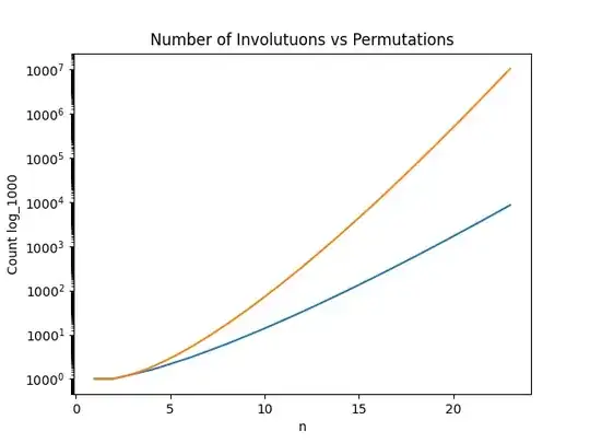

There are $n!$ (OEIS A000142) permutations of a set of $n$ elements, but much less involutions (A000085) for $n>2$. Orange is the number of permutations and blue is the number of involutions.
Number of Involutions vs Permutations
