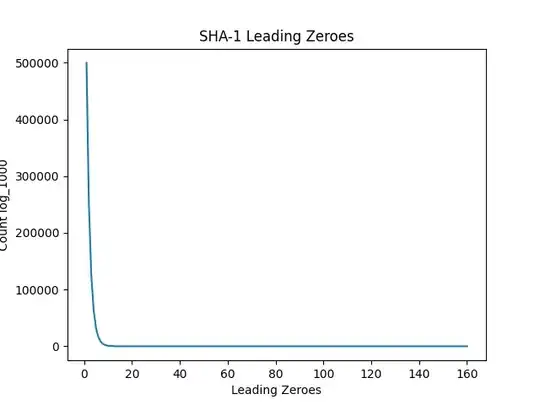

This is an extension of Maeher's answer and the full code of this answer is in Github.
Hash functions are expected to produce random output random in the sense that the value of the hash is basically unpredictable without actual computing. We, also, expect them to produce the hash result evenly, i.e. all possible hash values occur with the same probability. This means that we expect 1/2 of them to have a leading zero, 1/4 them has 2 leading zeroes, and so on. In a formal way; for $n$ trial we expect $n/2^i$ values have $i$-leading zero.
The below Python code experiment this (the below is optimized of the original. It is optimized on codereview at least 2x speed up )
import hashlib
import random
leading = [0] * 160
for i in range(100000):
hashvalue = hashlib.sha1(random.getrandbits(128).to_bytes(16, 'big')).digest()
zeroes = 160 - int.from_bytes(hashvalue, 'big').bit_length()
leading[zeroes] = leading[zeroes] +1
for item in leading: print(item, end =',')
Sample output is
1 2 3 4 5 6 7 8 9 10 49894,25040,12555,6251,3142,1523,787,392,202,111,49,21,10,10,6,2,3,0,1,0,0,1,0,0,0,0,0,...
the remaining all zero...
The graph of the event.
Note that it is possible to draw this together with $n/2^i$, however, they are so close to each other that one needs to zoom.

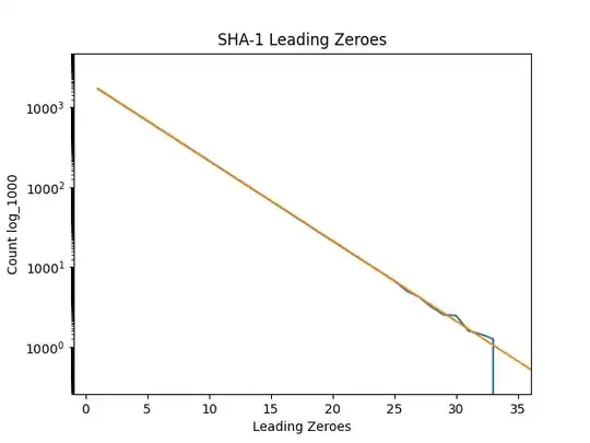

The below is the $\log_{1000}$ scaled $y$ axis with $10^{10} \approx 32$-bits random trials, 1K times more than above, took around 3 hours. With the result data
4999899716,2500040694,1250025163,625012247,312519435,156242195,78129201,39070485,19532263,9766270,4882962,2438565,1220675,610279,305021,152313,75950,38232,19141,9601,4800,2403,1200,610,305,127,75,32,16,15,4,3,2,0,0,...
This time the with $n/2^i$, which is reddish. Since the event is so small compared to space, most of the values are 0 that is the reason for the drop of blue.
A zoom on the initial part is the below figure.
This tells us that how SHA-1 outputs are close to ideal. We already know that is necessary but not sufficient and the attacks on SHA-1 verifies this.

    If ever a plot called for a log axis, it's this. – Maeher Aug 04 '20 at 17:13
    Should "9894" be "49894"? – bmm6o Aug 04 '20 at 17:55
    Your graphs say trailing zeros, but your code appears to be counting leading zeros. Did you actually count trailing for the grap, or is that a mistake? e.g. hex 7ab100 has 3 leading zero bits, 8 trailing 0 bits. – Peter Cordes Aug 04 '20 at 21:59
  • @PeterCordes thanks for the notification. A new was coming, but I need to break it now due to your notice. Anyway, faster code can run now. – kelalaka Aug 04 '20 at 22:17
  • Hash functions are expected to produce random output. — better phrasing would be something like evenly/uniformly distributed. Random function would be a quite bad hash function. – user28434 Aug 05 '20 at 16:42
  • @user28434 random output is usually considered as we expect them to emulate the random oracle. But we expect them to distribute the output uniformly, and that was the main point of the answer. I'll clarify more about that part. By the way, actually, by a hash design, we are chosen a random function from all possible ones, and eliminate those who are not good for Cryptography. That is similar for the block ciphers, too, where a key selects a random permutation from all possible permutations. --Thanks. – kelalaka Aug 05 '20 at 16:54
  • @kelalaka could you perchance add in the last bit of code that generates the three above graphs? – haneefmubarak Aug 05 '20 at 18:36
  • @haneefmubarak full code at github – kelalaka Aug 06 '20 at 13:46
