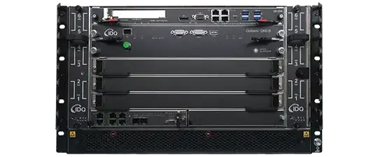

That's why there is a market for QKDNs. See all the interest in this older answer, and ponder the quotation at it's end. It's incredibly alluring, and if you want one, buy one of these:-
It's a node for commercial QKDNs. Cerberis from ID Quantique.
