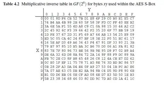

I actually do want to know how to generate the multiplication inverse (M.I) table, I mean the calculation how the M.I been generated.. such as the M.I of 22 is 5A regarding to the table.. Do you know how to calculate M.I how the 22 will become 5A

22
is the hex encoding of a binary polynomial $f = x^5 + x$ that is used to represent the element of the AES finite field (the field is defined as $F_{2^8} = GF(2)[x] / p(x)$) where $p(x) = x^8+x^4+x^3+x+1$ is the reduction polynomial.
Now, we need to find the multiplicative inverse of $f(x)$, i.e. another polynomial $g(x)$ such that $$ f(x)\cdot g(x) \equiv 1 \pmod{p(x)} $$ We can do this either by using extended Euclid algorithm for polynomials or using the fact that $f^{-1}(x) = f^{254}(x)$ because of the Little Fermat's Theorem.
Using a computational algebra package like e.g. GP/PARI we can compute
p = Mod(1,2)*x^8 + Mod(1,2)*x^4 + Mod(1,2)*x^3 + Mod(1,2)*x + Mod(1,2)
f = Mod(1,2)*x^5 + Mod(1,2)*x
g = Mod(f,p)^-1
and we get the result
Mod(Mod(1, 2)*x^6 + Mod(1, 2)*x^4 + Mod(1, 2)*x^3 + Mod(1, 2)*x, Mod(1, 2)*x^8 + Mod(1, 2)*x^4 + Mod(1, 2)*x^3 + Mod(1, 2)*x + Mod(1, 2))
so we get the reduced polynomial $x^6 + x^4 + x^3 + x$ and this encodes as 5A
, the table entry that corresponds to 22
The only element that does not have its multiplicative inverse is 00
, so by convention we define that 00
is mapped to 00
again.

Your method is not effective to generate the table. One can fill it at most $O(n^2)$ field multiplications. – kelalaka Feb 21 '20 at 13:49
@kelalaka: Yes, but the question was not about efficiency of the generation algorithm (BTW. for this size of the table asymptotic complexity is just a code golf exercise) but about understanding where do these values come from. – Kris Feb 21 '20 at 16:38
