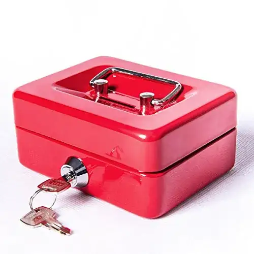

The classical trapdoor cage for lobsters is a good analogy.
The lobsters can enter very easily -> Everybody can encrypt with the public key
The lobsters can not get out without the opening the lock. Only the key owner of the lock can open -> Only private key holder can decrypt.
This analogy one more merit: There is a negligible chance that some lobsters can escape -> there is a negligible chance that you can find the key by trying some values ( assuming the scheme is secure)
And, you can buy some trapdoor for the demonstration, at least for mice.
Note: If you consider a trapdoor is bad for ages 11-13 you can go for locked cash boxes;
Instead of money use messages.

  • Could the downvoter explain the reason? – kelalaka Sep 28 '19 at 07:49
    The OP is asking for mathematical examples, not metaphors. – Mark Sep 28 '19 at 22:15
    I think I have that exact metal box in red over here. – Maarten Bodewes Sep 29 '19 at 21:36
    "The OP is asking for mathematical examples, not metaphors" .... Maybe the OP should rethink about "educational methods".... Math won't talk to 11yo children. Piggy box with padlock will. It's not because "that kind of maths" are ok for 11 yo childs that i will interest them. What is the goal ? Make them waste 1h ? Ok, go for math. Make them interested in crypto ? Then you may forget about maths ... – binarym Sep 30 '19 at 15:18
