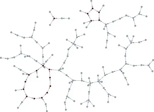

Here's an illustration that I stole from fgrieu of a 7-bit hash function—the vast majority of points, the grey dots, are not on cycles at all; only the red dots are on cycles:
A genuine guaranteed random mapping, courtesy fgrieu
Of course, in principle it could turn out that SHA-256 is actually a permutation of $\{0,1\}^{256}$ and is a single giant cycle, in which case you would actually have to tread $2^{256}$ steps—this, rather than the much larger $2^{256}!$, is the maximum number of steps before you are 100% guaranteed to have cycled back upon your footsteps. But it is exceedingly unlikely that SHA-256 is a permutation, let alone a cyclic permutation—this would be an astonishing development if proven.
