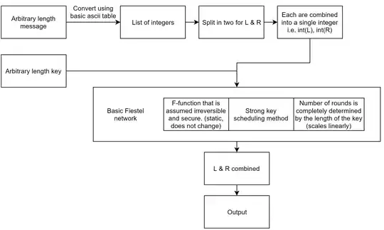

After looking at the Wikipedia page for the Fiestel cipher, I thought about making a variation of it that is very general.
I basically followed the diagram on Wikipedia in order to structure the algorithm. The way my algorithm encrypts messages follows this diagram (the decryption is just the reverse method as seen in Wikipedia):
General Fiestel Cipher Diagram
In case the diagram fails to let you know what is going on, I have made an implementation in python without a strong key scheduling method here.
The main question I have is what key schedule method should I create/use/adapt for this cipher? A side question is any general improvements that could be done. The key schedule needs to be able to generate an arbitrary amount of keys and be able to take an arbitrary length key.
    Well the key schedule seems insecure, but a Feistel network using BLAKE2b as the F-function would be secure, in theory. Unfortunately though, "analyze this new scheme" questions are off-topic here. – forest Apr 24 '19 at 06:41

It's not a good idea to assume that your F-function is strong by itself. With very few exceptions, it's not true even with professionally-designed Feistel networks. In fact, the reason Feistel networks are even needed is because they're used to build a secure PRP from an insecure PRP or PRF. Said insecure function must be designed so that it is extremely lightweight and is secure after sufficient iterations.
Without more information, no one can tell you how to design a key schedule. They're generally tightly integrated with the rest of the cipher. All we can do is give you possible designs that would be inefficient but would work, or which would only be secure assuming your F-function is a strong PRF (which is quite an assumption). You have to think about a few things when designing a key schedule:

If you are not making any assumptions about the F-function, then you could use an algorithm like HKDF to expand an input master key into an arbitrary number of subkeys. If you do assume that the F-function is a strong PRF, which it very likely will not be, then the key schedule could be as trivial as XORing a round counter (functioning as a round constant) with the key to derive each round key. That would be necessary to avoid the slide attack, but relies on assumptions about the F-function's security.

  • So the balance between performance and security is based on a balance between the F-function and the key schedule. Also I don't really mind about not being side-channel resistant. Is implementing a hash function within the F-function considered secure? – Lasagnenator Apr 28 '19 at 07:26
  • @Lasagnenator A cryptographic hash function (like SHA-256 or BLAKE2) would make for a secure F-function, but it would be unnecessarily slow. You aren't using this construction for anything serious, are you? It's great to invent ciphers for fun, but never rely on them for anything. A "very general" secure but inefficient Feistel cipher could use, say, SHA-256/128 in HKDF for the key schedule, and directly for the F-function. There would be easier ways to create a cipher out of a hash, though. – forest Apr 28 '19 at 07:27
    I'm planning on using this for personal use, it doesn't have to be efficient, I just want it to be secure. So a way to do the key scheduling would be to just hash the key and re-hash it for every round? Inefficient I know, but secure. Also, would the key length matter now as the key is hashed at every round? – Lasagnenator Apr 28 '19 at 07:39
    @Lasagnenator If you want it to be secure, then don't roll your own crypto! I'm a random person on the internet who does not have an advanced degree in cryptography, so while my advice may be sufficient for an online Q&A site, it should not be taken as accurate enough for you to design your own cipher. Is there a reason you don't want to use an existing cipher like AES (or Twofish, if you really want a Feistel network)? And yes, key length and keyspace still matters greatly. It always matters. – forest Apr 28 '19 at 07:41
    I want to have my own though. I also feel like having a cipher that can be modified easily whilst still being secure will make it harder for attackers to break it as the algorithm could change at any time. – Lasagnenator Apr 28 '19 at 07:44
  • Having your own and using your own are different things. If you really, truly want to be secure, use an existing cipher. It will be far more secure than anything you could put together. Plus – forest Apr 28 '19 at 07:45
  • Ok, I will think about it. – Lasagnenator Apr 28 '19 at 07:48
