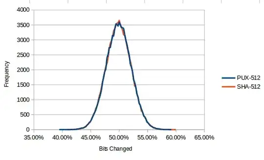

You might also want to look at the avalanche effect and it's calculation. It's simple (based around xored random numbers) and if $F$ is working, you'll get a normal graph centred on 50% like:-
ae
with (in bits) $ \sigma = \frac{\sqrt{block width}}{2} $. As my esteemed friend points out, statistical testing doesn't address all major security aspects of $F$. However it addresses some, and it does form a very good check on the mechanics of your algorithm.
